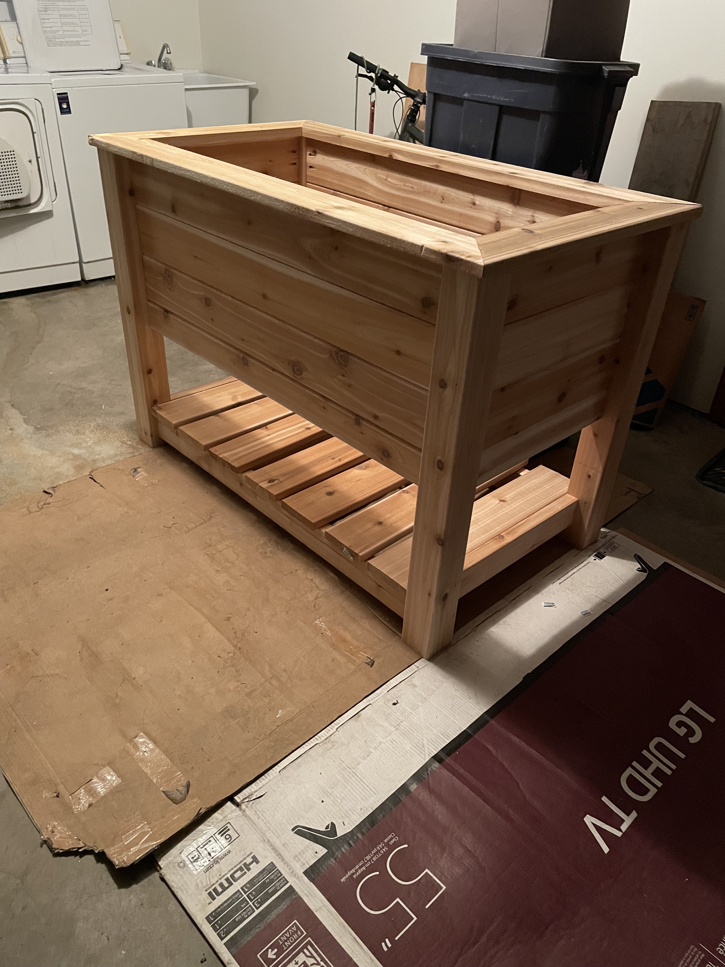

Back in the covid times my wife and i moved into our condo and one of the first honey do projects i was tasked as making a giant planter box thats roughly 6ft x 2ft x 2ft. I have since been asked to make one similar for one of my wife’s co-workers. I thought i’d share the plans, cut list, and the current price breakdown (that includes a cost for labour).
This features no complicated joinery, just screws and butt joints and took a few hours to come together. This is 100% doable as a one day build. Though filling it with soil was not cheap. I don’t recall what that cost but a rough calculation says you’d need over 275 liters of soil. I think i suplemented it with sawdust as well. I didn’t include it in the pricing because well… the wife paid for the soil the first time around and the customer is paying the soil so it’s not something i need to worry myself with.

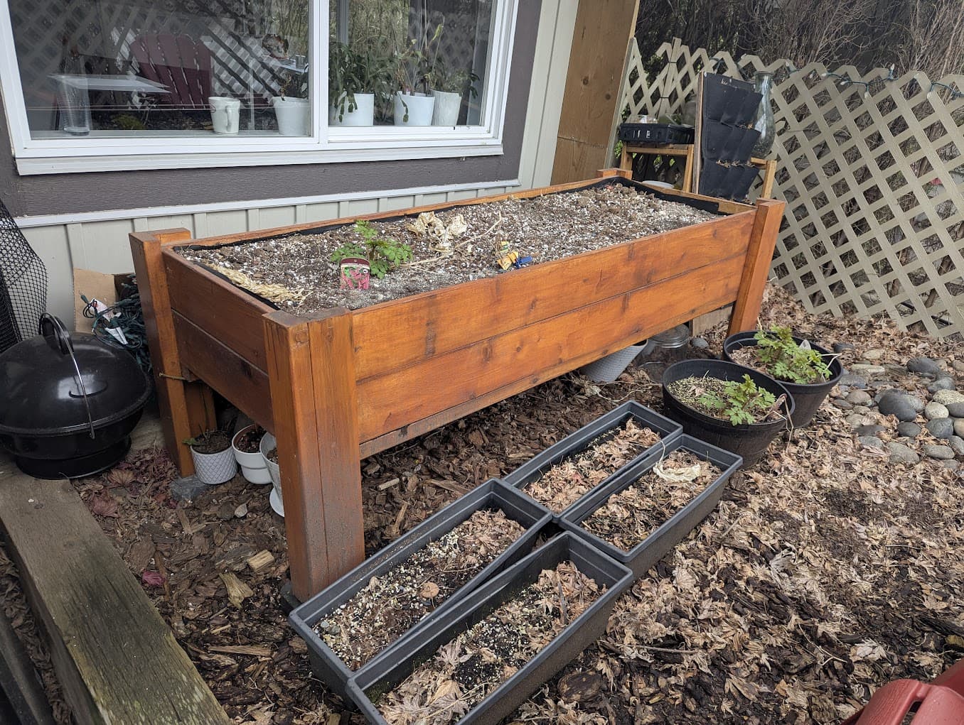

The planter - about 4.5 years later
The cut list and price list
The 3d model
Required Tools:
Circular saw and a speed square.
A longish straight edge.
Drill/Driver
Measuring tape.
optional - Tablesaw (probably just for one cut but you could do it with a circular saw too).
