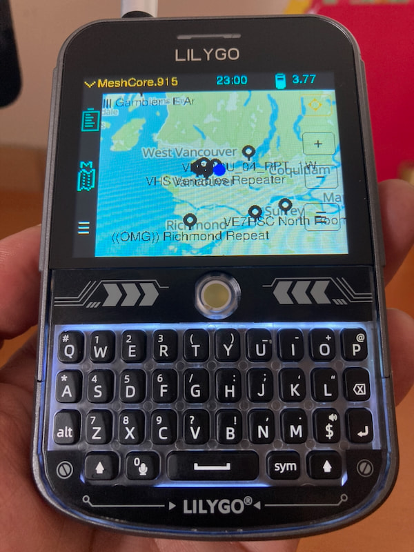

I’ve set up my T-Deck Plus and can see lots of nodes in BC and Washington. Also sent and received messages in the Public room.
I generated some map tiles for the Lower Mainland and northern Washington so the node map looks cool. Unfortunately you need to pay for an unlock code to zoom any closer than what’s shown in the photo. Seems like a few other T-Deck features are locked.

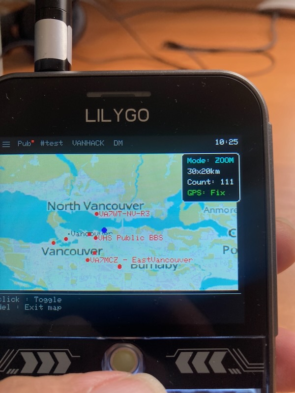

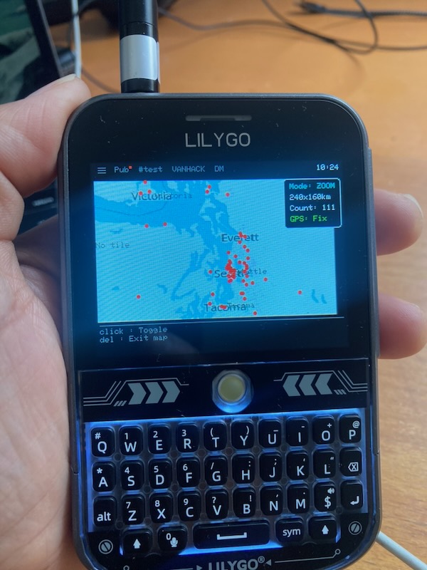

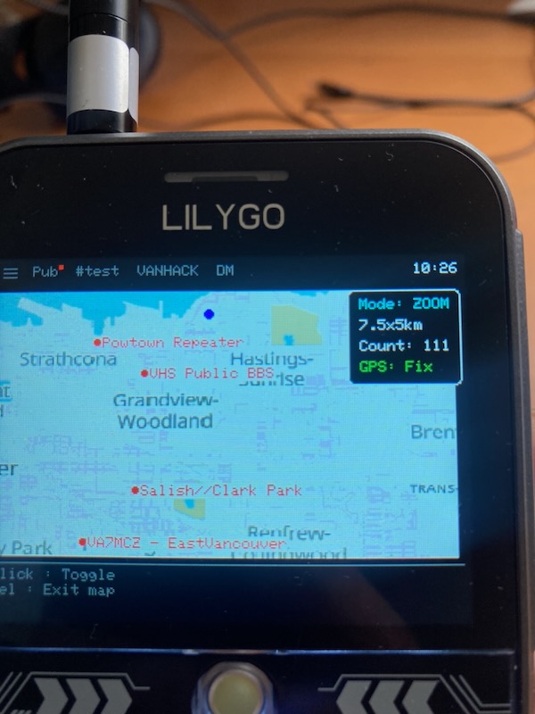

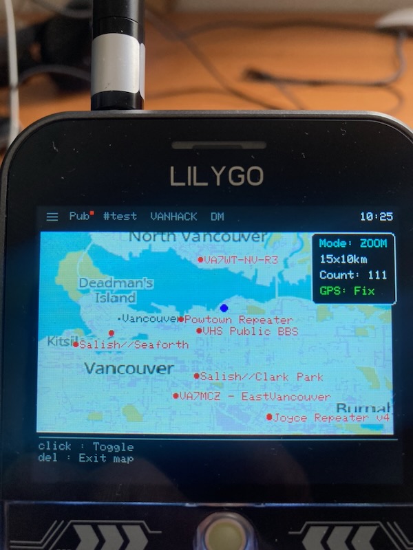

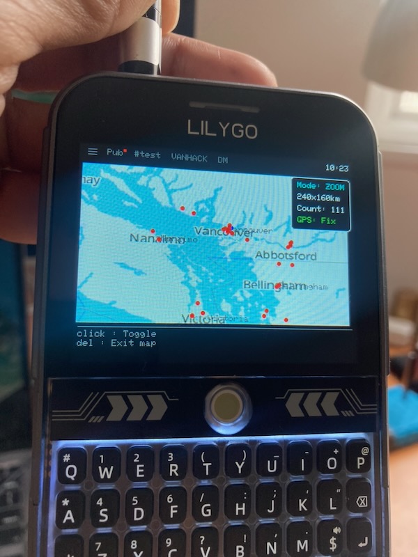

Offline Map Tiles for BC + Washington — z6 to z12
PNG XYZ tiles covering the Lower Mainland BC and Northern Washington region, rendered from OpenStreetMap data using Planetiler + TileServer GL. Standard XYZ directory structure (tiles/{z}/{x}/{y}.png).
  • Zoom levels: 6–12
  • Tile count: 2,183 tiles
  • Total size: ~34 MB
  • Format: PNG, Web Mercator (EPSG:3857)
  • Tested on: LilyGo T-Deck Plus running MeshCore
I’m still working out zoom level display issues on the T-Deck Plus — only 5 of 7 levels are currently rendering. You’ll also need an unlock key to see the higher zoom levels.
