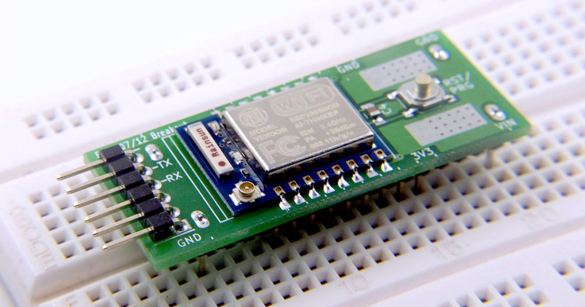

I used the ESP-07 version and got some breadboard adapters from here:
Now if I can only get some sort of build environment installed I can go crazy. There is a Arduino like IDE available but it crashes on my XP laptop so I’m going to try the Linux version.

I do highly recommend these as they have a small footprint and seem decently made…
They also have a single button that does both reset (if you push quickly) and puts it into the programming mode (if you hold it for a bit)…
They got here pretty quickly (3 weeks mebbe)…
